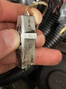

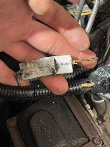

Hey everyone, new to the forum hoping y’all can help me out. Trying to diagnose a no start on my ‘87 bronco II with the 2.9l FI. I’m getting fuel to the injectors but no spark. Trying to trace all the wires now. Any suggestions/info is greatly appreciated!
Does anyone know what this is rubber connector is? Can I just splice these wires directly?

You can't just cut that out... it says diode right on it.
