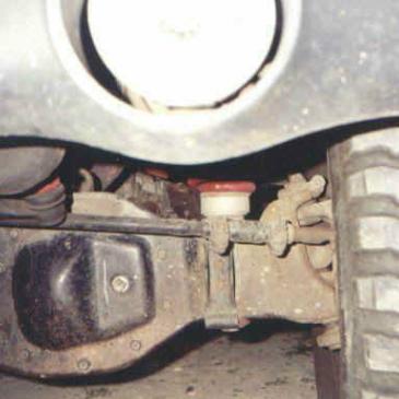

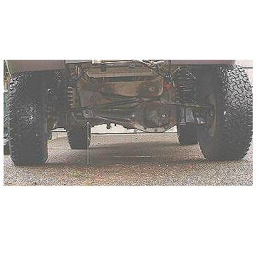

Look through these articles... they may help...
the Super Runner Steering conversion seems to math what I am explaining completely! can this be installed on my B2?
503
196
I have the super runner on mine.
You just can't buy them any more... at least from what I've heard.
