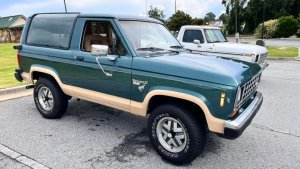

I was able to find some used / like new 215/75/15 Firestone destination white letters for $300, love them! And love your BII color combo, mine is the brown over tan. This vehicle has been a blast to work on, I’ll be an expert on 90% of it by the time it’s “done”…
