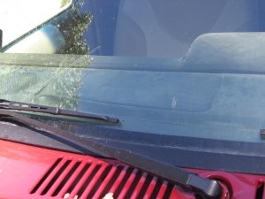

I know this is an old thread and I am really new but I found this and it is indeed the 4X4 controller. It clicks every time the 4X4 or low range is pushed. Here are location pics.
14911
14912
14913

On my 89' that's where the ABS ECM is located....according to the Haynes manual that is.
FIFER
Jan 26, 2020
Well , on this 89 it clicks when the 4X4 button or Low range button are pushed. Maybe it also works the ABS ??
