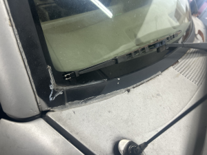

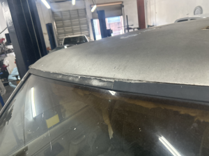

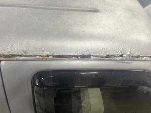

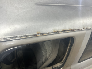

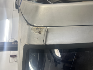

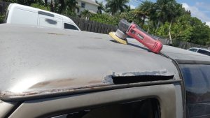

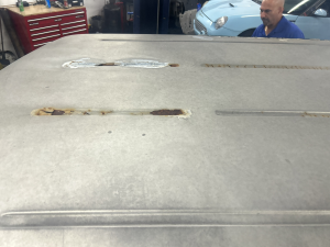

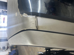

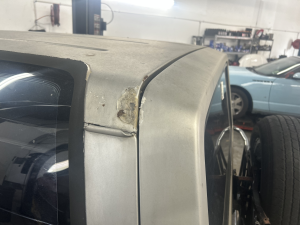

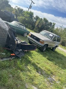

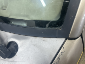

Well, with all this rain in Florida this week I discover why my car smells the way it smells. Smh. Small rust spots here and there but leaking from the top of the windshield, probably rotting. Long story short, TO THE BODY SHOP FOR A MONTH. Found a guy to do the work and use metal not bondo and color. Definitely gonna have to pull the floor off and replace, plan on using vynl for the floor, no more carpet

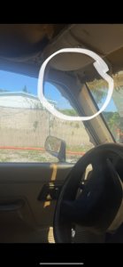

Driver side floor is wet, seat is damp, passenger side dry. I circled where the main leak is coming from in the last photo
If anybody knows any places in the west palm area that does body work at a reasonable rate, lmk please.

I had to the driver side drip rails dug out and repaired and as long as I had it at the shop I had them do the passenger side drip rail as well as the rear hatch hinge area. The only one that ever leaked was the drivers door drip rail

Thanks Dennis. Adding new metal and taking the old rusted metal away

I wish that was my issue. Smh. Taking the rust out and wielding new metal.

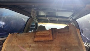

If anybody has a good link to a new headliner that would be nice. Nothing so far on rock auto
I’ll look harder

I have that link as well, but I don’t see a picture of it so I’m a little ugh about it
