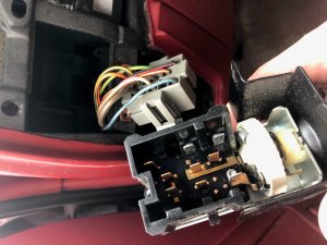

I pulled the main light switch and tried the test light again.
With the main light switch pulled, the test light blinks on and off like a hazard light. I am going to check again, but I do not think it was doing that when the switch was still connected, the test light was just off.

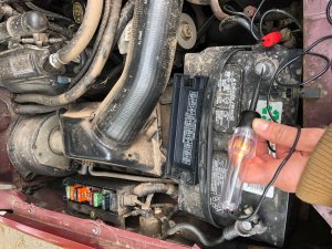

The first picture is the test light without pulling any fuses or disconnecting anything besides the negative battery terminal for the test. As you can see, the light is on.
I need to figure this out!
Is this definitely an electrical short?
353
128
Did you have the door open when testing? The dome circuit would cause the test lamp light.
