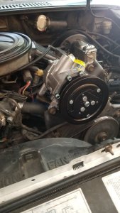

Began to reinstall the air conditioning the previous owner had removed. Fortunately he saved brackets, hardware and all the old components except the old compressor. Have new compressor, condenser, dryer, lines and evaporator. Had to pick up from a bone yard the manifolds that go on the compressor which the lines attach to. My wife will enjoy riding in it a lot more with a/c but the vent windows do an awesome job if you're not sitting in traffic.

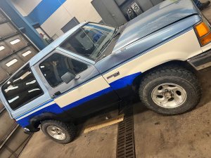

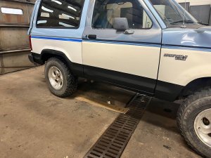

pulling my 1988 b2 apart fixing broken rt quarter glass and windshield , with rust issues so I can paint. Runs great so far

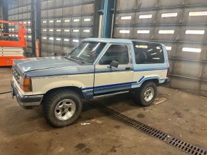

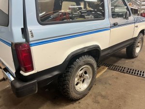

Bottom edges of the B2 were pretty rusty and i dont plan on re painting the old girl. so some POR15 on the bad spots and spray truck bed liner along the bottom edge it is! letting it dry for atleast a day before i pull the tape off. Maybe i will work on fixing my dash lights next.

Finished the bed liner coating on the lower part of the truck. came out pretty good. now just waiting on the new tailgate handle to see if I can make that work.

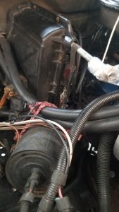

Replaced the coolant temp sender on my 1990 BII. Where does your temp show as being Normal on the temp gauge. The arrow on mine comes up to between the o and the r on Normal.
