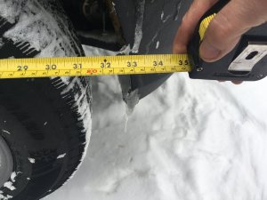

Here’s the latest issue, wife ran over a block of snow while turning around in an intersection. Ripped the front right inner fender out!
The good news is, after looking at all the room with the inner fender gone, I think 33’s would fit with enough offset to clear the base of the shock strut.
Crap, the video is gone. Luckily I posted it before my phone crapped it. I’ll get the link.
Edit: we’ll, my i6s finally crapped out. The screen digitized and I lost 90% of everything. So, with my i10 I’ll make a new video because the one I uploaded to my YouTube channel is gone too for some reason.
(YouTube “low range in Nova Scotia “)
Bracket racer
Jan 20, 2022
36
19
2021
Badlands sport
Wife wanted to take it to the dealer Monday morning, but it’s snowing here…again…
Good news is, with the
inner fender gone, Im sure I could fit 33’s!🤭🤭
31’s easy! There is a lot of room inside the fender well with the inner fender gone. The ONLY thing in the way is the spring plate on the strut. Offset rims and no problem!

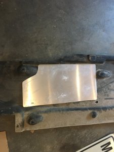

Been gone a while… more damage😂😂
Windshield
Broke the tabs holding the inner fender in when it got ripped out.
Tore the bottom skid plate cover almost in two when the wife bottomed out on a rock
